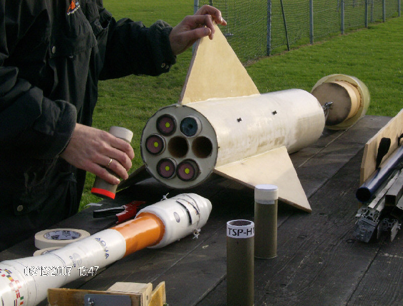

I will try to give an answer to all the questions.

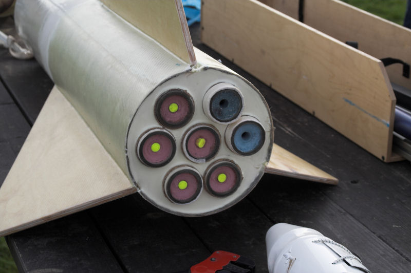

Neil is correct stating the rocket survived the engine failure pretty good. Although it was a big bang causing a lot of damage. The parachute and plunger are beyond repair and need to be replaced. The nose cone is heavily damaged but can be repaired to I hope.
I think the following went wrong.
Not one but five of the motors blew trough. and two did their work.
When the rocket started and the engines came to pressure (taking a fraction of a second ) the rocket lifted of from the launch pad and even before if left the rail the motors failed. I can not say for sure it was coursed by some kind of chain reaction , one failed and kicked the other five engines so hard they cracked to. Or they just failed all five due to a production error.
The two engines that stayed in the rocket worked well and where from an other production series. (Same type different date).

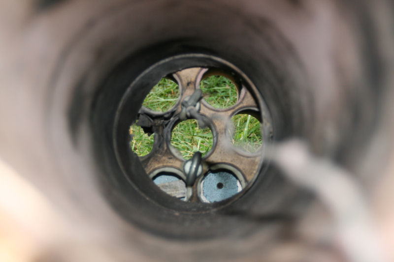

The trust plate in the rocket had 7 big holes to be able to make use of pyro wadding instead of black powder. The idea is when making use of 7 engines you will have a very reliable ejection system . All the ejection charges where linked and when one goes of they all will. If one fails there is no problem. (6 left for back up)
When a black powder motor fails it normally kicks it fuel block out on the top side, and this is what happed here. The holes where big enough for the fuel to go trough and the explosion pushed the casing out on the bottom side of the rocket. Only the motors that exploded where thrown out of the rocket. The trust plate stayed on its place ,and there was no rocket failure.
When I study the movie files, pictures and remains of the rocket.
I come to the following conclusion.
Five engines failed.
And threw their fuel on the top side out, one or more fuel blocks exploded in the rocket , one hit the plunger and burned the inside, two went on to the calculated apogee.
Two engines worked fine and stayed where they belong. On one of the movie files I saw yesterday they can be seen burning out with the rocket laying on the ground.

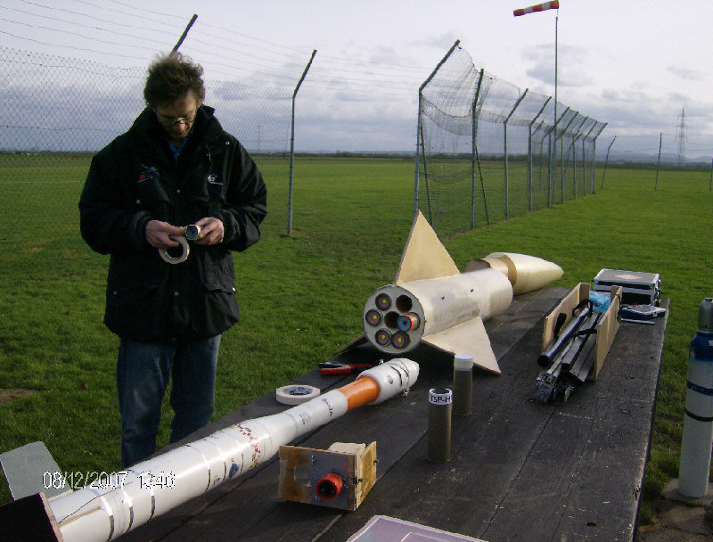

The tape I used on the engines was only there to get them centered in the engines tube. And as we can see I works ok as long as you don’t blow up the motor. The two motors that did not explode stayed in . Even with the more than calculated ejection charge.
It was definitely not used as trust block or what so ever. The rocket has a 20 mm massive trust block build in that survived the explosion with out a scratch
After the crash I did a ground test with a left over motor, and It also blew up in the ground.
I think we all heard the bang.
I hope this is an answer to all the questions.
Jan-Hein

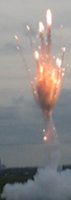

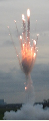

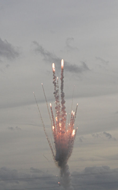

habe mir das Video eines Freundes mal genauer angeguckt und Bilder der entscheidenden Szenen gemacht
t+ ca.0,8s (die Nachfolgenden Bilder jeweils ca 1/30s später)
links sieht man deutlich eine Flamme zur Seite schlagen
Hier sieht man wie sich die Rakete infolge des Überdrucks bereits trennt
Die Rakete hat sich hier bereits soweit getrennt, dass Grains nach oben geschleudert werden.
Links (an der Stelle wo bei t+0,8s die Flamme zur Seite schlug) ist nun fast keine Flamme mehr zu sehen.

Ich lad mal eben ein Video des Startes in höherer Qualität hoch (25mb) wenn einer das mal in Slowmotion machen könnte, würde man viel mehr sehen.
EDIT:
Hab mir das nochmal langsam anguckt, man sieht deutlich links einen Blitz und daraufhin schiebt sich die Rakete auseinander. Dannach entsteht dann die große Wolke, aus der nicht mehr viel zu erkennen ist.

Ich hab hier auch nochmal drei Bilder des ganzen Szenarios:
vorher:
währenddessen:
nachher:
Die Bilder hab ich auch noch in besserer Auflösung. Siehe Archiv.
Wenn jemand die Bilder als RAW-Datei haben möchte, einfach melden.
Gruß Robert

Hi Dennis,
Slow Motion ist hochgeladen, trotz mpg immer noch 29MBfrown
Ich denke, Jan-Hein`s Analyse ist zutreffend. Auf Deinem AVI-File sieht man gut, dass die beiden "Ausreisser" auch Treibstoffbrocken sind, das Rendern in mpg und wmv hatte jedoch eine Verdoppelung der Leuchtpunkte wegen der schnellen Bewegung `reingerechnet, so dass es aussah, als wären das die beiden hellen Klebestreifen-Ringeembarrasment
Sch... Digitaltechnik, mit Super-8 wär´ das nicht passiertwink
Im Ton hört man keinerlei Knall (außer dem Aufschlag der Rakete), habt Ihr "live" Einen gehört?

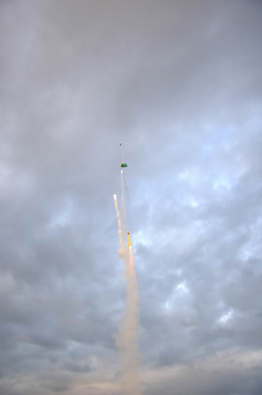

Echt spektakuläre Bildersmile !
Erstaunlich ist aber wirklich das nach so einem gewaltigen Cato das Modell so wenig beschädigt wurde.
Wahrscheinlich ist die Art der Motorbefestigung bei diesen SU Motoren doch echt eine gute Lösung...
Wären diese fest verankert gewesen hätte es das Modell sicher in Kleinteile zerlegt.
